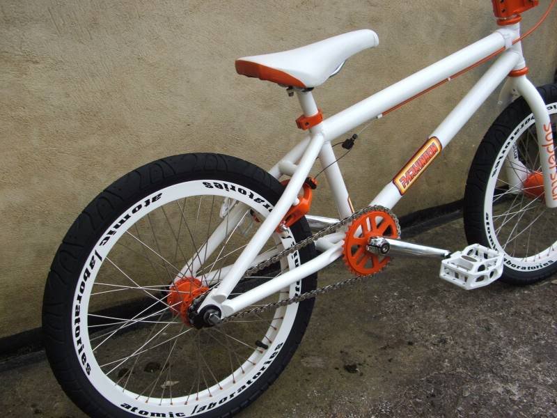

I have had loads of rims powder coated, no problems at all.  Although you do get some binding when heavy breaking as the fricton heats things up, but this doesn't happen often.
All these rims of mine are powdered.
