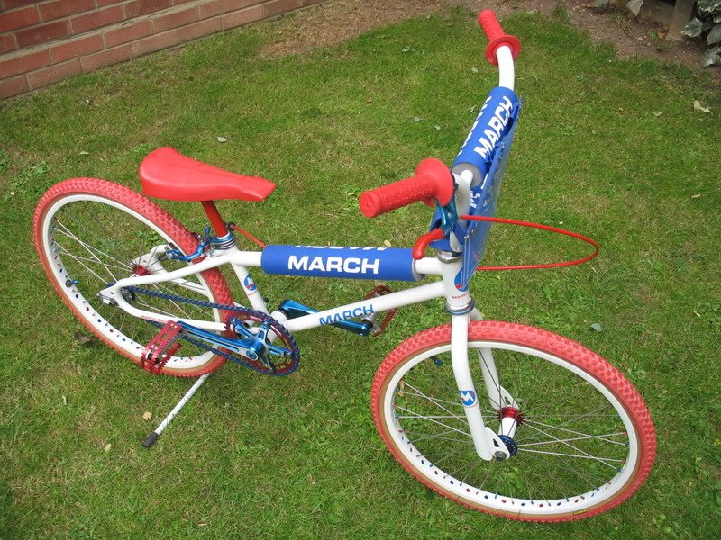

the rims are 20x1/3/8 and the spokes are a pig to find >:( i had to have the spokes made for the wheels on this

Sawzall - that mini is awesome! Love the detail in the wheels - where did you end up getting the spokes made then, as I'm not looking forward to the blank expression on my local shop owner's face when I take them in....  :-\

Re: 1983 Minigoose narrow pro-class rims - help required!
« Reply #9 on: November 17, 2007, 09:34 PM »
i got the spokes made up at a ga cycles in southampton,they made a cracking job of the wheels and very quick service ;)
