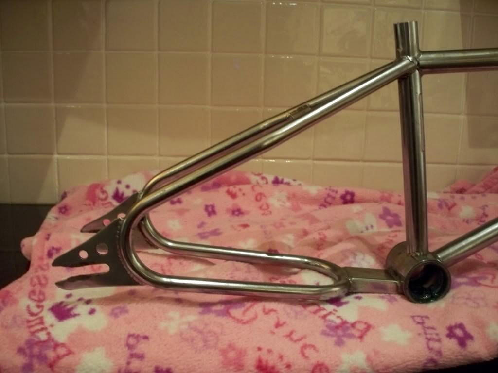

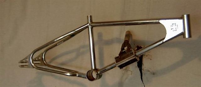

Hi Guys,
I have had a load of help and advice on this frame (you know who you are guys, thanks)
I thought i would post it up for some comments (all are welcome)
Gonna get it restored and i was thinking of white with new decals ?
I have been told its a Californian full cromo, maybe a prototype because of the dropouts.
It also weighs the same as a Supergoose/ touch lighter but does not have 3 holes in the brake bridge and has the thinner rear triangle tubing.
The stickers are repop by the guy i bought off so ignore them.
Can anybody give a definative answer on reading the serial number.
Cheers all

That date is right on the change over from Gusset goose to Non Gusset goose.
April 1983.
Here's mine but it is a very late gusset model

Anybody seen those kind of rear dropouts before ?
Re: Your comments please Gentlemen
« Reply #3 on: November 26, 2009, 09:39 PM »
I've chatted with Paul about this frame both via PM on here and on vintage - my 2 peneth for what it's worth :
1. The lack of additional holes in the brake bridge and thinner rear tubing mean it is not a standard USA supergoose 3
2. The dae means it is too early to be a UK supergoose
3. The fact that it is so early and yet so light and the position were the seat stays meet the seat tube should rule out a tri-moly cali
4. The dropouts are different to 83 cali and supergoose frames
Conclusion - fook knows  :LolLolLolLol:
It's earlier than any other recorded californian frame that's registered with vintagemongoose.com and yet does not share the rear tube geometry of a super and then there's those dropouts.
My final thoughts were that it could be a cali prototype   :)
Whatever it is..... it is quite unique and i would leave it in it's original chrome to keep it as original as poss  :daumenhoch:

Back on the topic of the dropouts, the only thing they even look close to out of the mongoose range are the mongoose "twofour" cruiser dropouts - similar angle and shape but 3 holes rather than 2 and without that slight "dip" in the top of the plate.  :-\

Could be a custom frame specced for a factory rider, would be a shame to lose the original chrome on a unique frame like that.

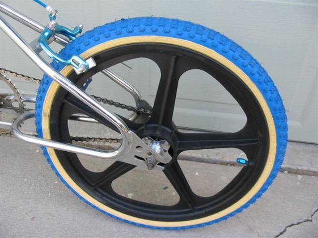

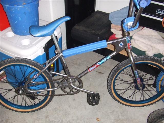

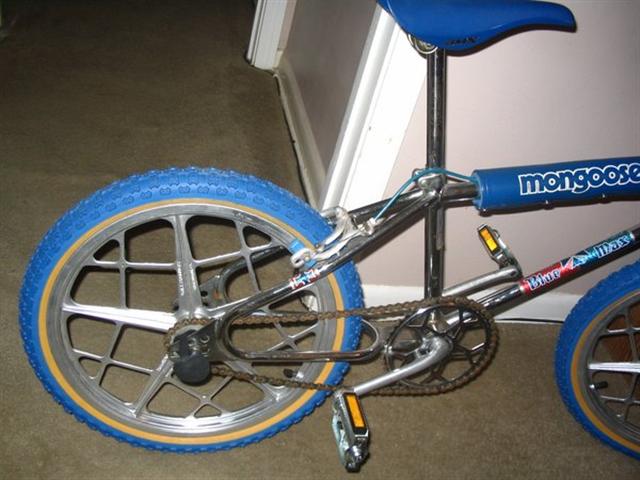

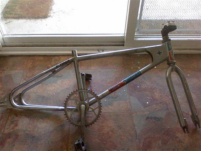

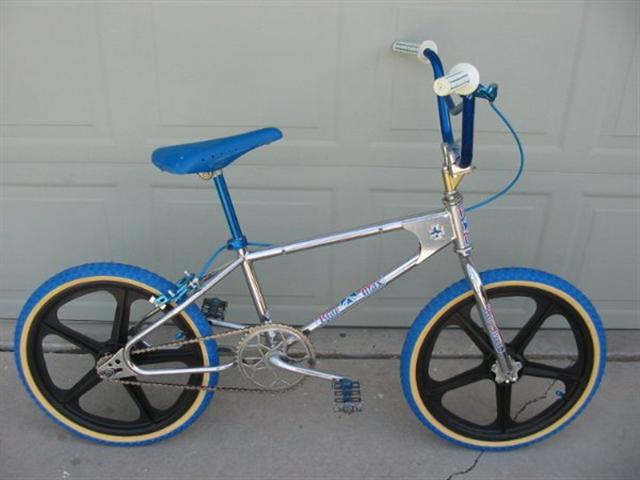

Right then.........
It's been a while since this was first posted up but, Paul, I have finally identified your dropouts and............
They are blue max ones ! :shocked:
They are the dropouts found on the late 82 - 83 iron cross gusset blue max frames.
What they are doing on a cali frame dated April 83 fook knows ! I can only now assume that it was a welder's error BITD as he grabbed the wrong dropouts during a very early production run of the calis.
And therefore a freak frame ! Very unique  :LolLolLolLol:
But they're deffo 82/83 gusset blue max frame dropouts - take a look........
Same shallow step down in the top plate and downward angle of the axle slot  ;)

Are you saying it's effectively an Iron Cross gusset Blue Max without the gusset or am I reading it wrong? ???
Well....
The way the rear stays meet the top of the seat tube is closer to a how gusset bluemax than that of a cali of the same era as well so I guess effectively it's like the rear triangle is from an 83 gusset blue max and the front triangle is from a cali !
Prototype frame ?
Welder's mistake ?
Either way that's what it's made up of  ;)

Umm, This frame is a 1984 Blue Max.
http://bmxmuseum.com/bikes/bmx_products_inc/7775
« Reply #18 on: January 22, 2010, 11:58 AM »
Yep but that one has the standard step down dropouts like on a cali (i.e. deeper step down in the top plate of the dropout and axle slot is parallel to the ground not angled down)
Coastvl
« Reply #19 on: January 22, 2010, 12:07 PM »
Yep I see that now. I'm guessin being the changover model in 83 it has the gussett model dropouts on a no-gussett frame. Sweet!

Wow what a response !!!!!
John, you lived up to your reputation as king of all things mongoose !
So... What is it for definate and how unusual or have I got just some strange cock up ?
I have been collecting parts and getting some wheels refurbed, new Suzue hubs, Asahi etc
Got an original Mongoose stem and cranks, pro class bars etc etc.
I havnt done anything with the frame yet as I want to get it right.
The chrome is in bad shape so I am tempted to get it re chrome but still not sure !
