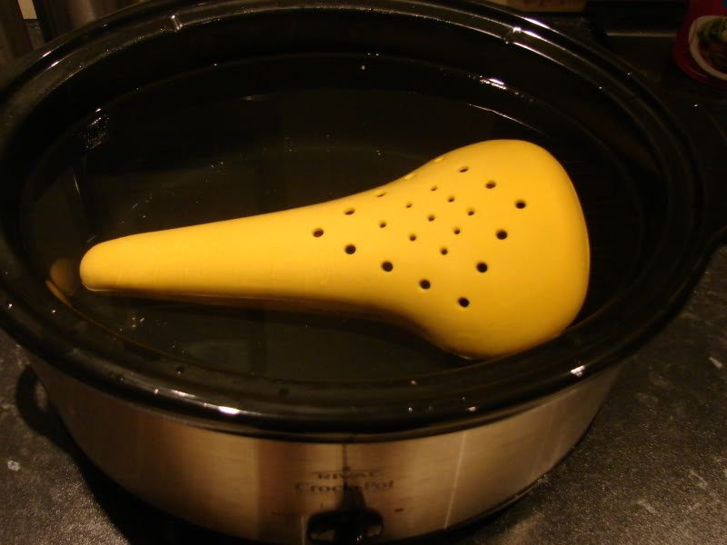

i put up a wanted to swap my yellow seat for a red one tonight ,,because i thought if i dyed it ,it would go orange
so after a while i thought fook it
get the crock pot out and bang the seat in with some scarlet rit dye ,,this stuff rocks
its maybe a little darker than i wanted ,,but its better than nothing  ;)
in the crock pot she went
photo with flash
and without

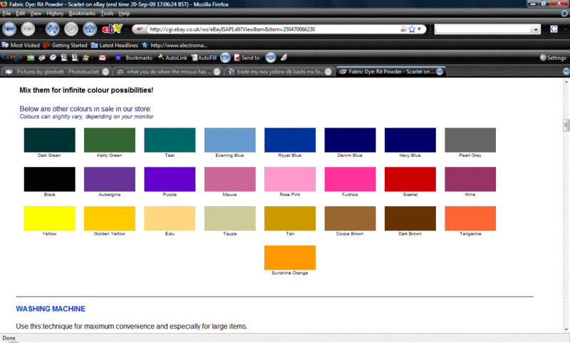

looks great mate ;) is that a slow cooker? and where do you get the dye from?
cheers
trasher
Re: what you do when the missus has gone to bed ,,rit dying again lol
« Reply #4 on: September 09, 2009, 11:43 PM »
[/quote]
nice work mate , when i read your previous thread i thought " here comes an orange seat "
i was thinking that aswell  :2funny: in for a penny
cheers
it is a slow cooker mate ,,,had to wait for the missus to go to bed  :LolLolLolLol:
got it from fleabay mate
http://cgi.ebay.co.uk/ws/eBayISAPI.dll?ViewItem&item=250470066230

cheers mate. im gonna have a go at this. whats the process?? ;)
trasher
« Reply #9 on: September 10, 2009, 12:00 AM »
I thought this was gonna be a left handed website thread, or at least underwear sniffing....
shhhh thats another site i use room7.com  :LolLolLolLol:
i take no responsibility for the outcome of your plastics  :LolLolLolLol:
your best off with starting with a white item ,,,thats why i was a bit hesitant to dye this ,,,,,
most colours will dye black though ,,,,
get the slow cooker and fill it with hot water ,,,or a saucepan ,,,i was a bit scared of the plastic touching the side of the saucepan and melting ,so i opted for the slow cooker ,,,have it on the top heat setting and not the slow setting
couple of cups of salt ,,,,disolve the dye in the water add the seat ,,,and keep an eye on it ,,,untill desired colour is achieved
wash it under cold water to close the pores up on the plastic ,,,,,it will need cleaning ,the salt makes it go dullish
then either spray over with wd40 ,,,,or i used baby oil on this one
i just happend to have some lying around .from a previous prostate milking episode  :buck2:
there is also a step by step ,in the tech stickies on seat dying  :daumenhoch:

What dye colour/code is it exactly then  ??? I've got a couple of pots of Dylon "scarlet red" i was gonna use to freshen up a dull faded seat as i had done the same using black dylon on a faded seat before - but maybe what you are using is the way forward :-\
trasher
« Reply #13 on: September 10, 2009, 12:30 AM »
Top results  8)
Dunno why you reckon it's a touch dark - from the pics on my screen the colour looks about right to me  :daumenhoch:
hello mate dont know the code ,,,but its rit dye scarlet red ,,,the americans mention it a lot on there sites so i thought i,d give it a go
