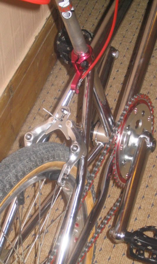

heres my pitbull posi stop on my free agent
cheers Kev

brilliant! thats what I needed to see!
so you didnt use the adjuster that came with the pitbull and just used the posy to guide the cable instead?
B

yes brettnai  like in the piccy

like this... sweet

yeah its one or the other
i think the posi clamps look nicer me self
so i went that route
but with the standard thing you get a spring don't you?
which would def help the cam go back into place
cheers Kev
