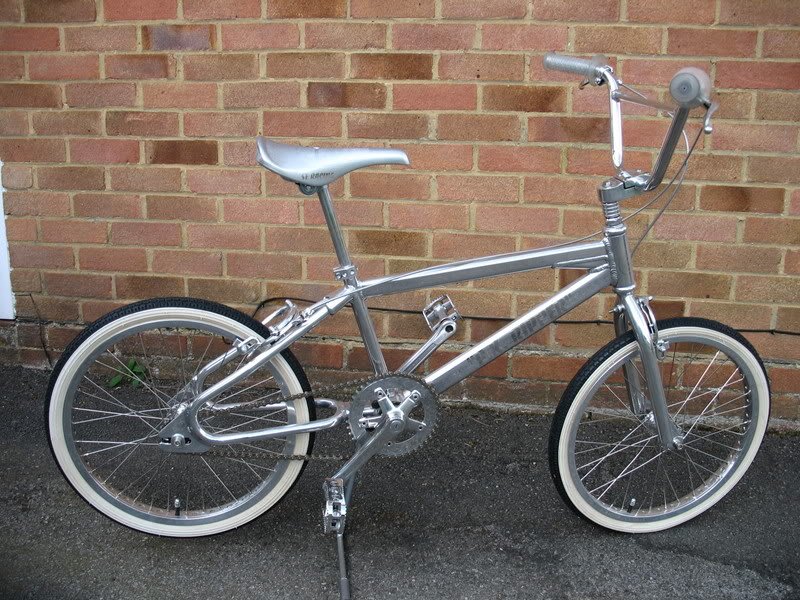

I got these cranks done at Custom colour, you will never get a finish like this at home

Cool bike. I have sent an email to Custom Colours so hopefully they will get back to me with a quote. I would only do it at home as a last resort.
If they did your cranks, then I expect my stems won't a problem for them.
