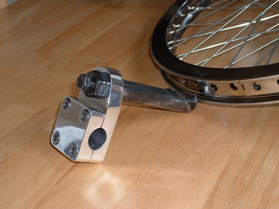

here you go dave....stripped and polished...i always do mine with a bit of jewellers rouge for the final buff...on my lambswool wheel, slow though
before
after

BLING BLING our dave  8).
