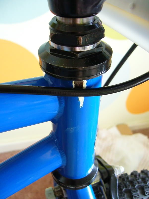

Both set of bearings are facing outwards. Do these pics help ?  :-\
Goose1
Re: headset probs
« Reply #8 on: September 30, 2006, 04:49 PM »
No they don't....the best way O is to sit the bearing cup on top of the bearings whilst holding them in your fingers, then spin......the correct way will spin the free-est and fastest and for the longest time..... :idiot2:
