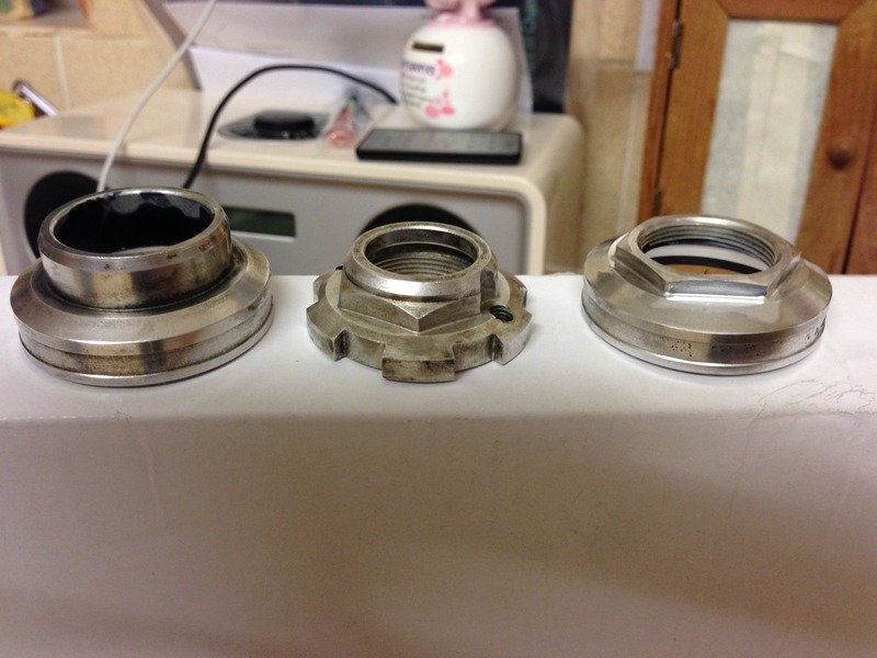

After putting trade ad's up on a few separate occasions, and getting zero responses I took a brave pill (may be a stupid pill in some people's minds) and got the oven cleaner out before moving on to the polishing wheel. Think they turned out ok. Sorry if it upsets some but I did try to trade before hand.
After the stripper:
and then some polishing:
finally some of Del's finest and all finished:

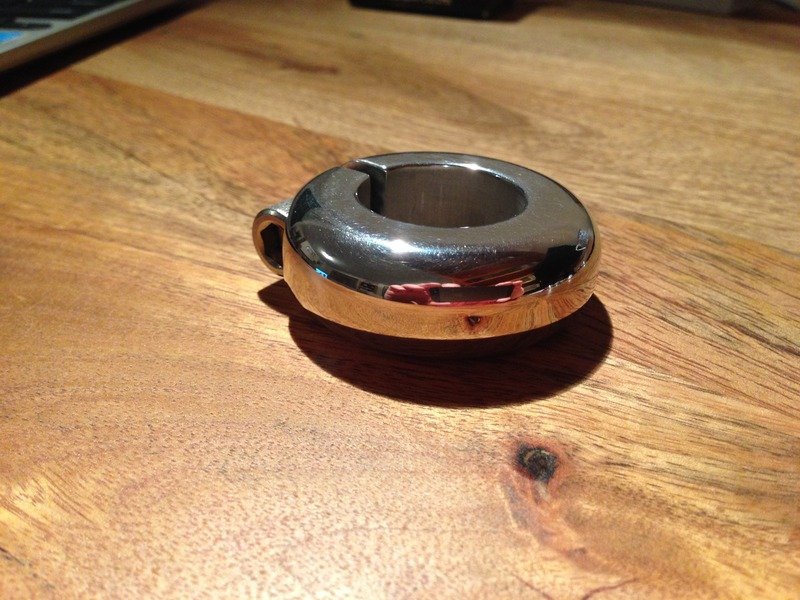

And the seat post clamp:
NOS (don't hate me):
Stripped:
Polished:

liquid drain cleaner is better to use than oven cleaner. less likely to pit the item you're de-annoing.
and much better for your health!
you want the stuff that has the same ingredient as drano. i think it might be sodium hydroxide.

As above, oven cleaner has some pretty nasty stuff in it. Go to your local hardware store and just ask for caustic soda. Still pretty horrid stuff but its the best product for the job, and when you are done pour it down the drain and it will be clean as a whistle.  :LolLolLolLol:
