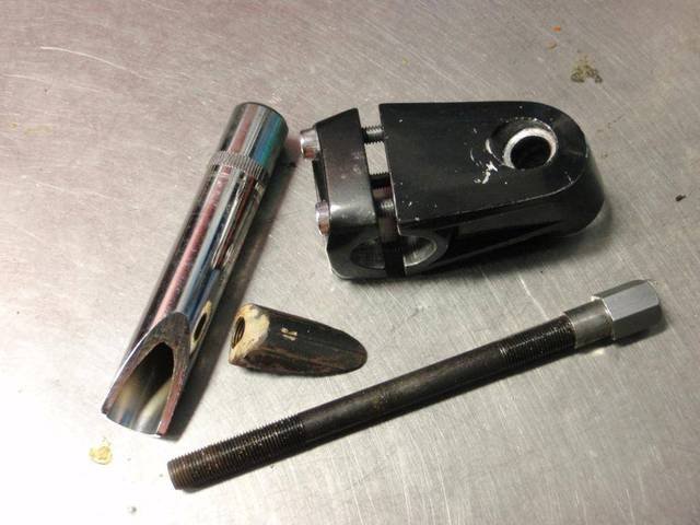

Thanks guys, yep they are longer and different to normal ones
This isn't my stem but you can see the bolt on it, I might be able to make one out of a two piece bolt if I can find one

The freestyle ones are higher because the race stem bolts are tightened using an allen key into the center of the bolt - this doesn't work if you're running a potts mod, so the stem bolt is higher to allow you to spanner tighten them.

its possible you may have to drill the stem out a bit, the redline/suntour version forklifter stems have a wider diameter freestyle bolt than the race bolt.
