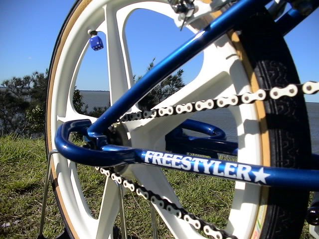

That may be a good starting point to be honest mate. I want to put a few old school touches to it though like Hutch fork standers, Curtis rear frame standers, 990 rear mounts with cables running internally. Stuff like that mate so, I thought I would ask everyone to get some pics up of their favourite parts.
I really like the Curtis rear stands -

The problem is with the Curtis rear hoops is that your heals keep catching them as you ride which is not good at all. I had a Curtis freestyler but couldn't bloody ride the thing.
Great info mate, thanks. This is the stuff I am after, experience and first hand issues. I can maybe re-think the position of them and the length of the rear stays too with this info  :)
