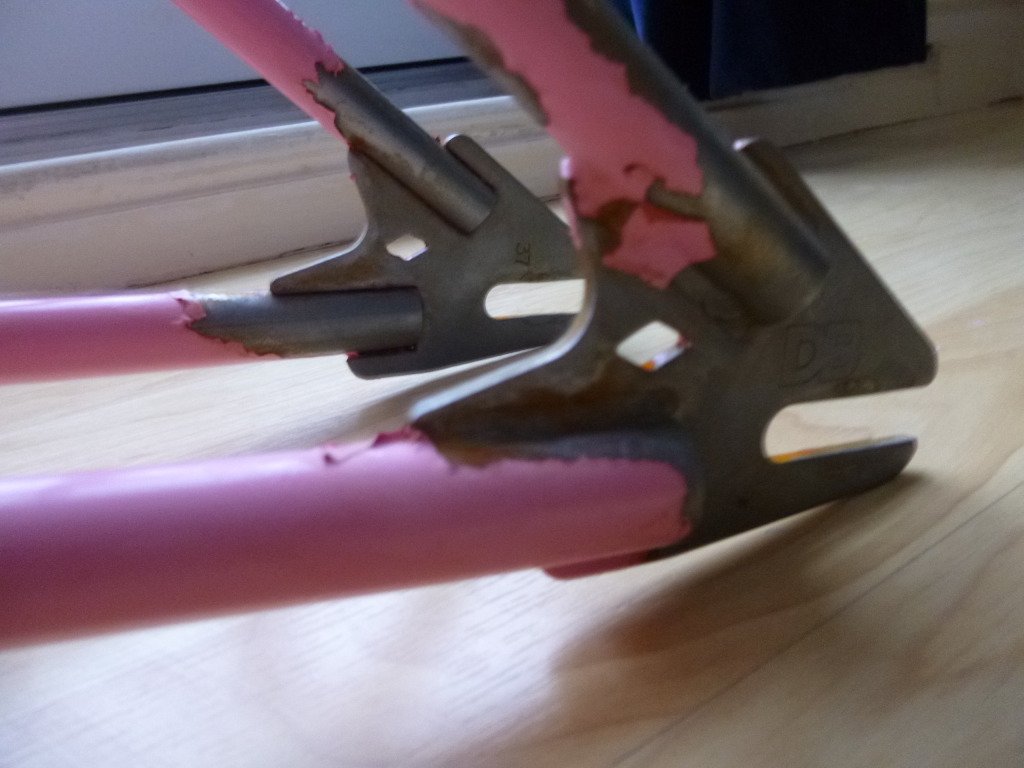

I wanted to base the build on a haro sport/fst shape frame. I missed out on Wini's Peregrine expert, but I got a tip off that member curtispro was selling his mid 90's diamondback venom that had been badged up and powdered as a haro replica. It was in very good nick when I got it, with full haro decals in place. The pic below shows it when I was part way through stripping the powder (was a bugger to get off!).
I wanted to remove all traces of the bike bearing a brand, in this case diamondback (no offense diamondback fans!). I therefore needed the db logos and diamond shaped holes in the gussets & drop outs filling in. I also wanted the cable guides on the frame and forks removing. Only one person to send it to then: Phil (Sawzall) (thanks Phil!). He did an amazing job, and also removed the rest of the powdercoat.
