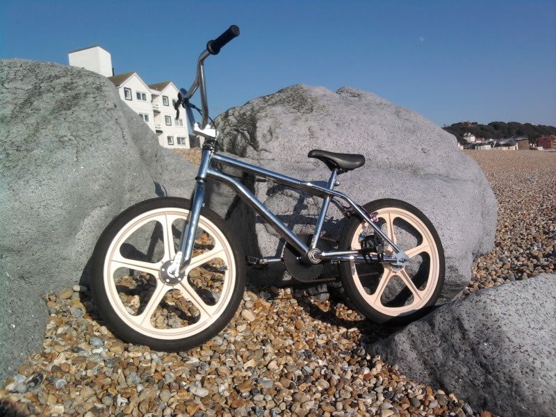

I had a pair that I bleached, they came up a bit brighter, but no where near white, they are naturally cream, so you'll never get them white  :daumenhoch:
That said they looked the part on my lads old school frame

So BENDYCAT, are trying to tell me that you dyed cream acorn magnums black, blue, red and yellow?
Re: Cream pinkish Acorn wheels.
« Reply #7 on: July 25, 2012, 10:11 PM »
 :angel: yup - I got the sets you see on the lawn - they were dirty and had turned cream - at this point i think that the material used to create them turns from a white to a cream over the years
I bleached some and then learned to dye them with dylon dye - polished the hubs on the black set
sold a load and only have a few sets left
as for how deep the colour of the dye goes ? it's less than a milimeter - as it only covers the mags and doesn't penatrate that deep - so brake rub will show after a white if the colour under it is different
how you dye them is a big part of it  ;)
cheers B  :coolsmiley:
