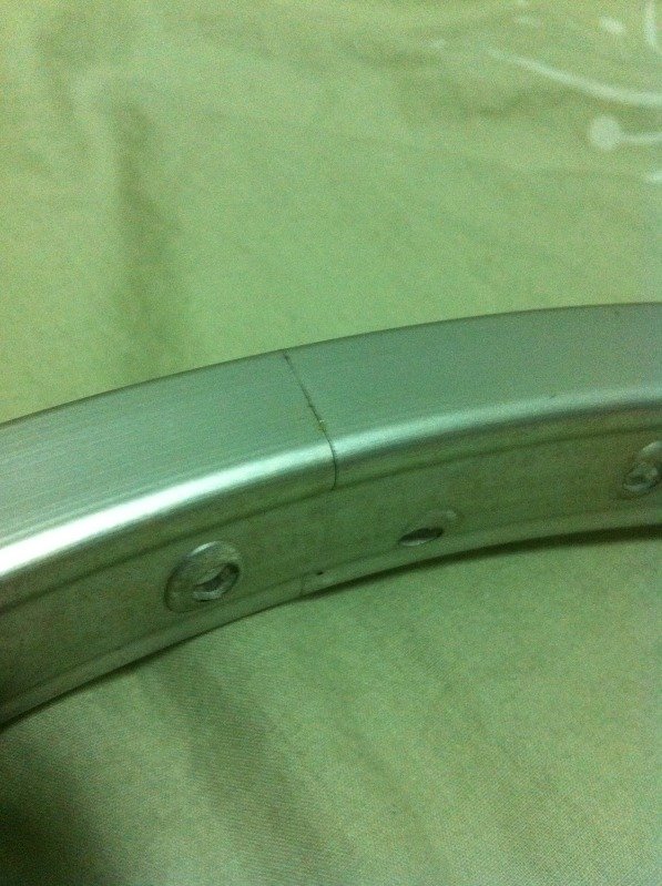

Is this visible join line normal in a set of Araya 7X 20 x1.5 ?. Looking at 4 NOS rims , totally unmarked never used but all have the same line. Does not seem to affect the strength of the rim but curious as I dont have any others to Compare to. Runs the whole way around

Just the join where the 2 ends of the rim are pinned together.

Do they have an Araya stamp on them?

Yes mate stamped ARAYA 20 X 1.50 Japan

Aha! 1.5's so these will be from the mid 80's onwards - looks like they are just pinned and maybe welded internally (if at all) and not at all externally. Shouldn't affect the strength but would have been cheaper for Araya to make

Yep i remember them having that join as a mate had them and the brake pads would leave a `catch` mark just the join.
