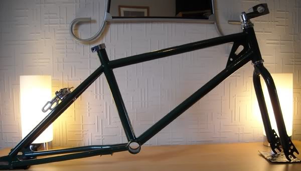

got this of a rad member just because first it was cheap,  :daumenhoch: (nice one D) second i liked and still do like the look of it , had a bash at searching for an id but with not much luck , i've set myself a £50 budget for this,   as one of the reasons for getting the f+f was to find a use for a bunch of parts i have lying around, you always end up having to buy something so i thought i do it justice and spend as little as possible  :LolLolLolLol::daumenhoch:
so set to with the nitromorse (fekin stuff burns like fook  :LolLolLolLol: )
noticed a dink on the chain stay and the horible seat stay, seat post junction with crimped tubes, quality  :LolLolLolLol:, so bit of chemical metal and a bit of sanding,
all in all not a bad result, brazed frame cleaned up ok , time to dig out the old head set after a quick blast of paint to keep the old rust away,   " feck me it dont fit "   the head tube is to big , shim shiminey shim shim sharoo's then , short story made long i had abit a thin ally so made these, fits perfect now
then came the crown on the forks or rather lack of  ?
more substantial shim needed here , chopped up on old stainless pan ,shaped it on the old akisu's,  then final fit with an ally spacer meant i had to bash it in place  :daumenhoch:

color change and bung on few other bits,  crank set next , but i think i'm going to break into to the budget again for this as the one on it is a non starter, its possibly and i,m still looking into this a 1938 williams?  date stamp research is never easy  :LolLolLolLol:, spent £6 so far on paint  :LolLolLolLol:
